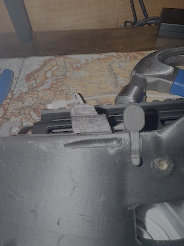

And, basically, yes; the ejector groove is too short for the printed ejector (so the upper could not be closed fully onto the lower due to interaction of the ejector and the "absent" groove). I made a slight modification to the ejector which seems to have fixed that issue.
As you can see I cut a notch out of the rear 1/3" or so of the top rear part of the ejector; it now functions properly and I don't imagine this will impact its long-term durability (any more than a printed ejector has "long-term durability".
