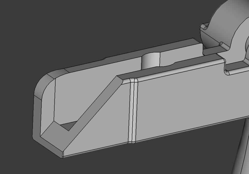

Houstonhls You had stated that the hammer has fallen causing a light primer strike on the 2nd round, moving more material from the trigger would not fix that.
The cut trigger in the picture looks very roughly cut, there should be no burrs on the side or extra material that isn't flush on the inside wall, the corner itself needs to be smooth without jagged edges. Take some more time to polish it out.
