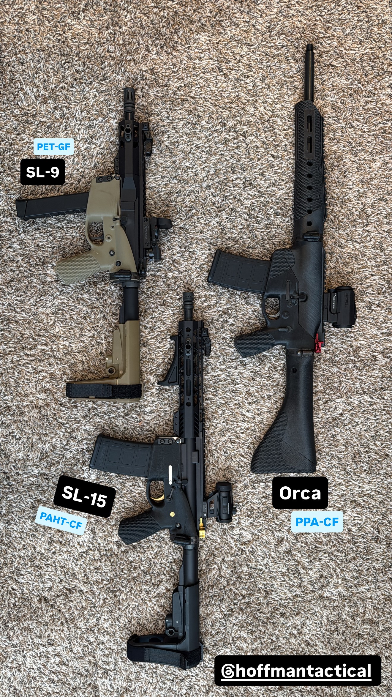

Attached are photos of my Hoffman Builds. Love your designs!!
