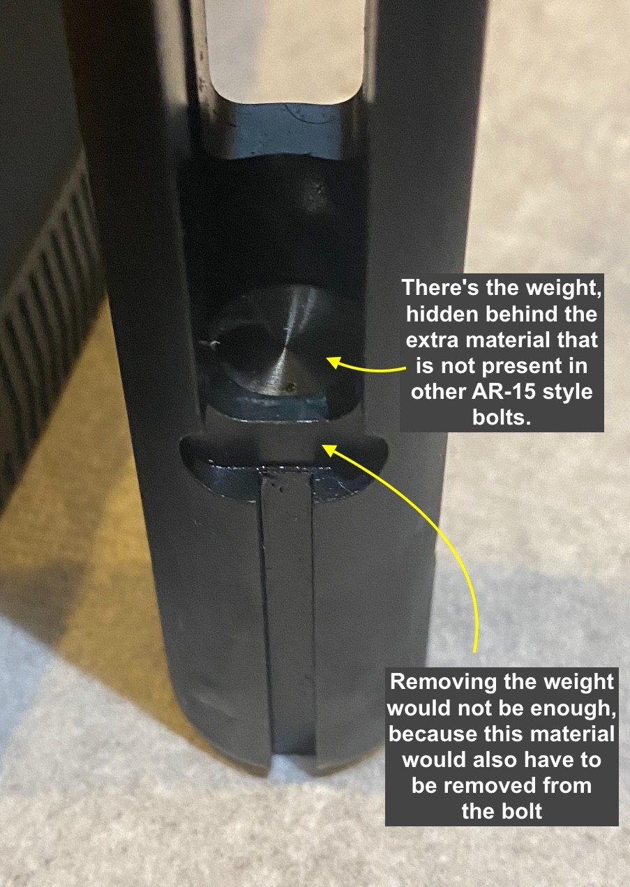

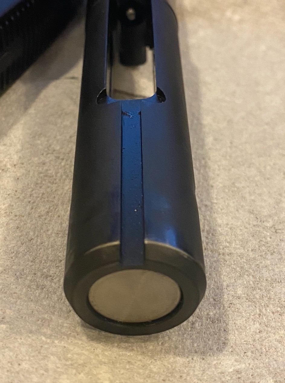

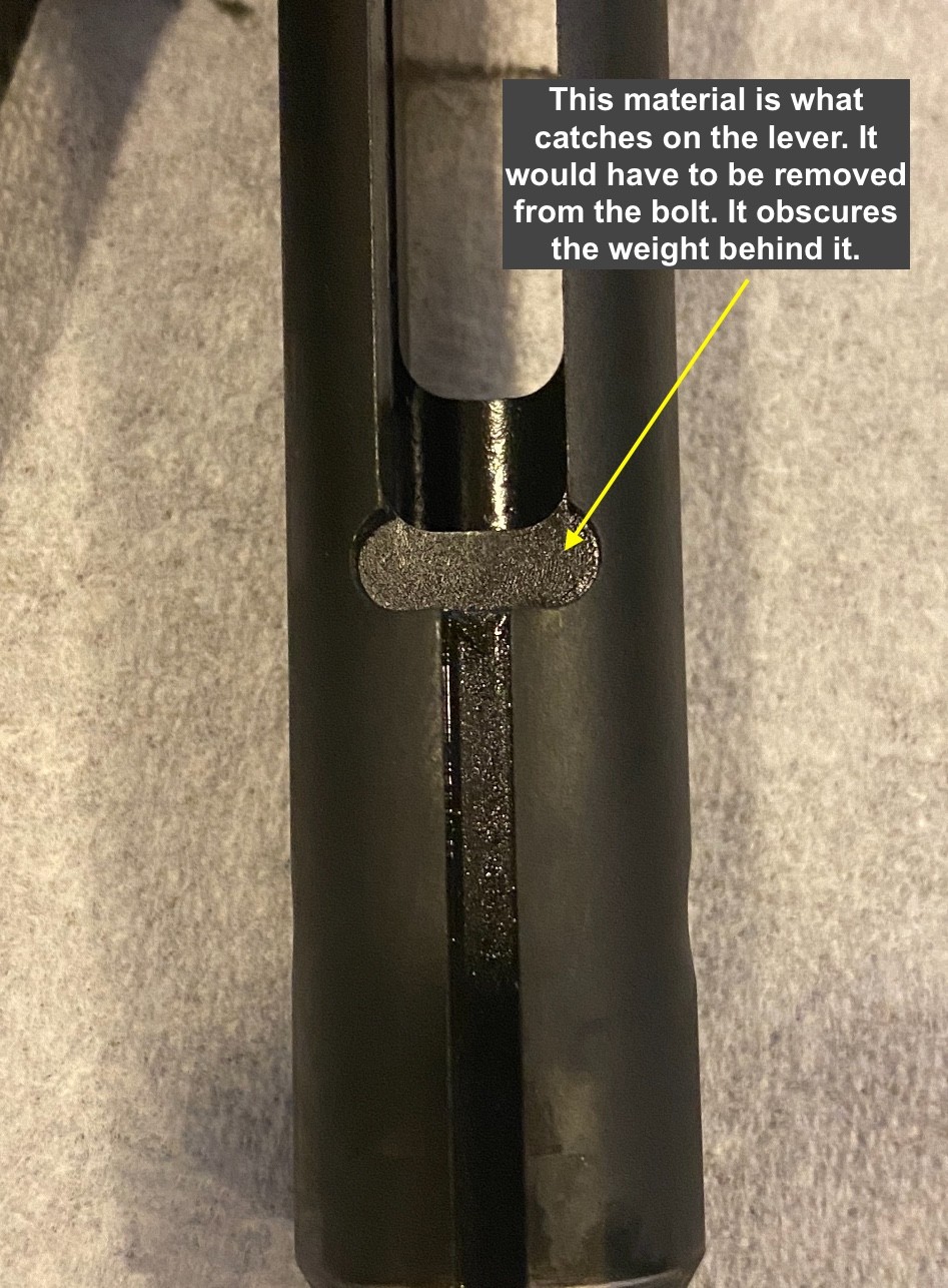

1) Many install videos say cock hammer back, SS lever forward, leaning against the hammer, to close up the upper (rotating it closed while rear pin pulled). I noticed on the DD PCC that the upper will not close in that configuration. The SS lever touches the bolt carrier geometry just a little. However, if the hammer is forward, the SS lever then rotates forward just a bit more, and the upper closes up normally.

3) I haven't test fired it yet. The bolt on the DD PCC is pretty heavy duty, and it has the factory installed Kynshot hydraulic buffer and factory spring. I wonder if bolt bounce will be an issue? This is where I feel a little nervous about testing this out. I don't want to experience an out of battery discharge. Has anyone else tried it on the DD PCC? I saw the Micah Mayfield video where he ran the same DD PCC with an FRT. It seemed to run very well, but who knows how else they modified that gun in the video. Thoughts? Should I mess around with buffer weights or springs before testing?
