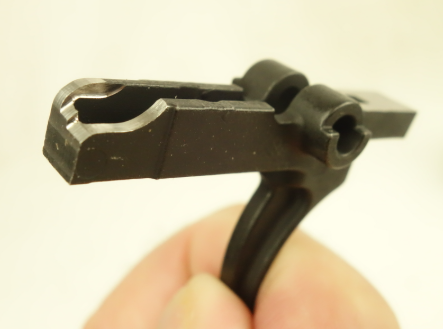

danster125 Does the right side of the trigger need to be cut at the 45 degree angle or can I use this trigger?
undeadchew danster125 It just needs to clear the cam, so if you put the cam ontop of it and that area doesn't touch it's okay.
