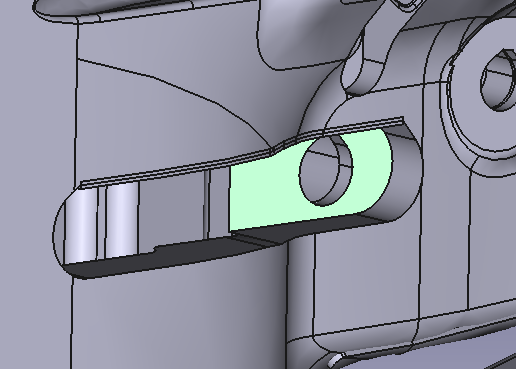

    I haven't had any kind of issues like this, however it sounds like the mag catch is not positioned deep enough into the mag well, perhaps removing a little bit of material on the lower could make it sit deeper.
    Another idea is you could bend the mag catch in, if you don't want to modify the lower.

      The above surface pointed out by @undeadchew is definitely worth checking, the catch should visibly protrude into the mag well. It could also be a damaged mag, if the catch hole on the mag is broken at the edge, it won't hold.
      Lastly, a very loose mag well will allow the mag to shift to the side and fall out. A little looseness is normal, but more play than you would find on other (functioning) lowers is not good.

        undeadchew Not getting my hopes up just yet as I haven't gotten a chance to fire it yet but dry cycling it the mag is not getting pushed out now that I have slightly bent the mag catch, if it does work in a live test I may sand down that wall a bit. Thank you so much for the advice!
