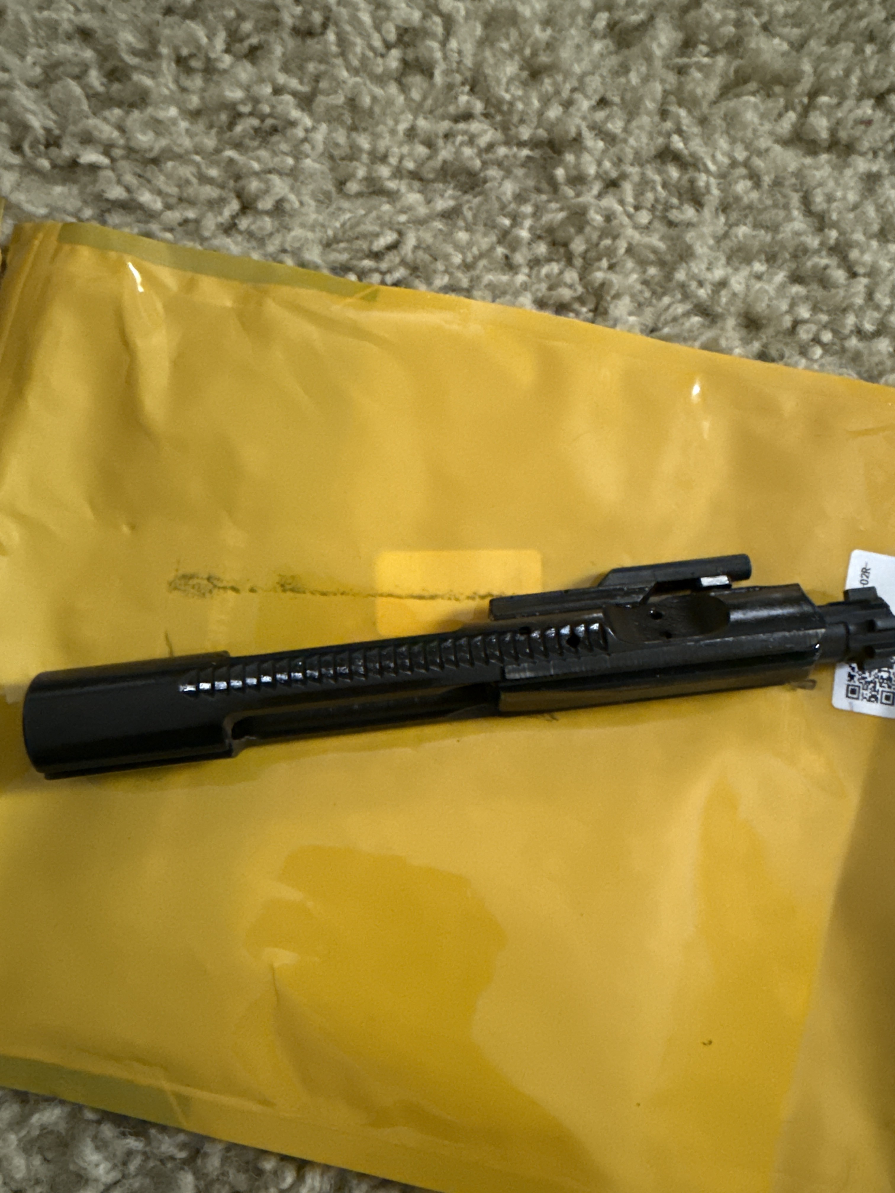

It’s probably because you have a semi auto BCG. After charging the rifle the BCG is not brining the level back in the forward position due to the cut in the semi auto BCG. And because of that, the level is stays in the back position which blocks the trigger form being pulled.
Brandong3125 even when I disconnect the lower it still won’t fire on super safety you sure it’s the bolt?

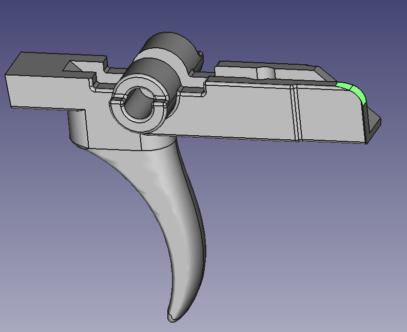

Could be that the trigger isn't cut/rounded enough.

I've previously addressed the two main issues I've come across with purchased metal super safeties.
https://forum.hoffmantactical.com/d/181-how-about-a-super-safety-trouble-shooting-page
Firstly the one you are dealing with where the trigger has too much material highlighted in green. I used a file to make small refinements removing a little bit of material at a time and then testing.

undeadchew hey thanks so much man i really appreciate all the help!
